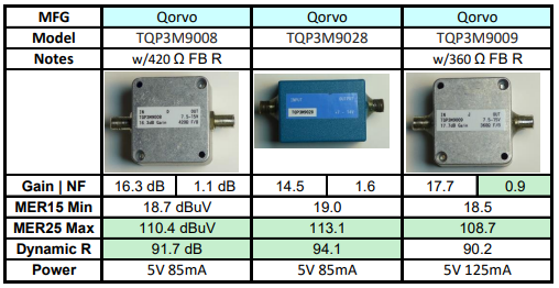

                    The TQP3M9028 amplifier is the one that I have used most often. After my feedback resistor tests, I have built some alternatives:
Name:	TQP3M9028 Replacements.png
                    I think that I will put the above TQP3M9008 amplifier to use outside.
                      Interesting new data.
