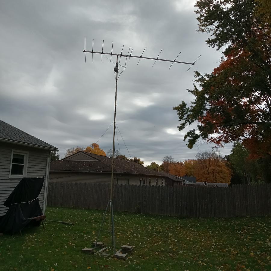

    The first picture is that of my APS-13 at 20 feet above ground level. The mast is guyed. It sits on a five foot tripod that can be lowered so I can check the antenna or lower it before a bad storm or a very windy day. This was on my roof until a year and a half ago when we got a new roof installed and I wasn't about to drill too many holes in it. It's only ten feet lower than it used to be. There's a little less IBOC with it a little lower; otherwise not much difference than when it was at 30 feet agl. The town is mostly flat but this area is around 200ft asl so that helps too.

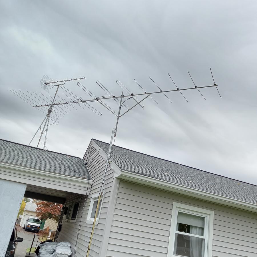

    The next photo is that of my FM phase antenna, a Channel Master Stereo Proge 9. This has been sitting in my basement for some years and I decided that this is the time to take it outside and use it. It's only around 15 feet agl but combined with the APS13 and the Bolin Phase Box, it works really well
    Off to the left are my TV antennas, which at this point are mostly for TV viewing (especially WHCT-LD ch35 and its MeTV programming). The UHF antenna is a genuine XG-91 and the VHF antenna is a Winegard antenna, one of the last ones manufactured and is VHF only.

    Ten feet and you notice less IBOC.That's nice. I hope it's a meaningful degree. Since you can raise and lower it easily, maybe you can try it even lower down during Es season and see if you find a sweet spot. I have blockage to the east (a cliff) so there's been considerable trial and error (and relative success). I'm curious about this trend of pointing upwards for Ms (and presumably Es)... (I've not been at my site until now for several months so am just getting set up again).
      Nice setup, Mike. Does your phase Probe 9 antenna with the Bolin box reduce I-BLOCK any?

        Yes, between the two antennas and the Bolin Phase Box I can phase out just about all of the IBOC down into the noise, or close to it. By the way, the same goes with the RSP Duo and its phasing method. Phasing works best with both antennas pointed in approx the same direction, but you can still phase if the phase antenna is fixed in one direction and you rotate your main antenna.
