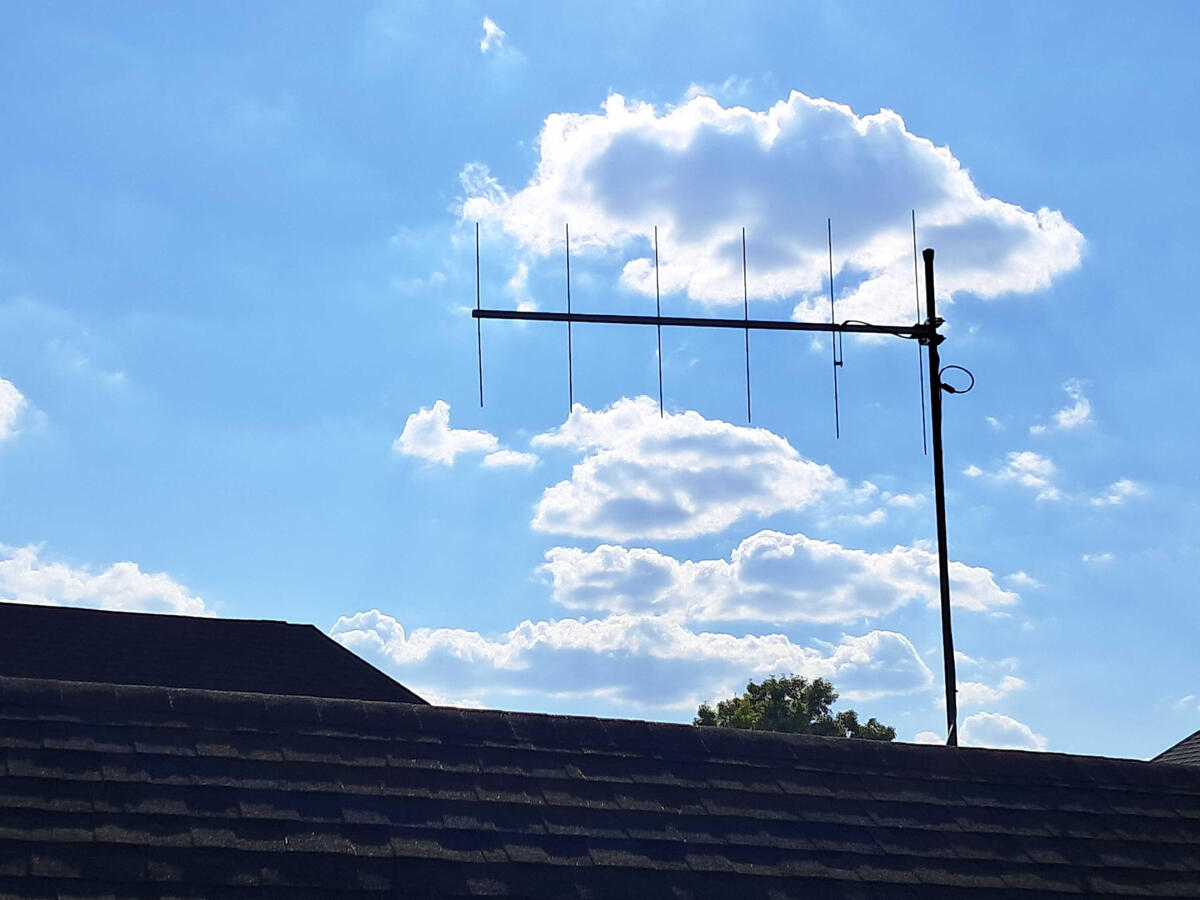

    The Stainless Steel Solid Element Arrow Antenna for 162 MHz is a game-changer. Up until now, I've done most of my DXing on the weather band using either a 5/8 whip on my Yaesu VX-150 or a 5/8 J-Pole feeding my AirSpy HF+ Discovery. While both worked well, the 6 element Yagi is much better for nulling stations and digging out weaker signals underneath. Plus, this thing is built like a tank. It will survive almost anything extreme weather can dish out. Made in America by Arrow Antennas. Price including shipping was $204.00. A small TV rotor can easily handle it. Instructions for assembling the antenna below. Click image for larger version

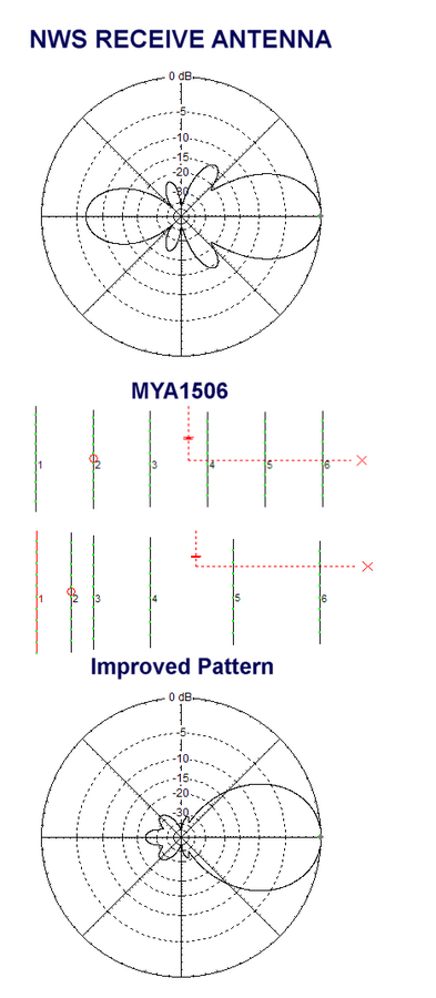

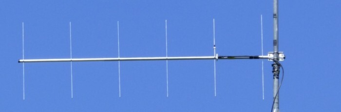

        It comes with a graph showing the element lengths needed to for the desired frequency. I tested my first one and found that its front-to-back ratio was too poor to permit the desired reception. I redesigned it and its directivity was significantly improved:
        Click image for larger version  Name:	MYA1506 Antenna Upgrade.png Views:	0 Size:	137.7 KB ID:	1810Click image for larger version  Name:	MYA1506 Antenna.jpg Views:	0 Size:	14.8 KB ID:	1811

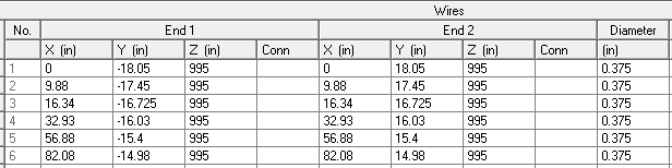

        The picture of the actual antenna shows it being tested before I modified the element lengths and spacings. Yagi's with evenly spaced elements are a poor design​. The upgraded antenna received the distant station fine. I have installed three of them at different locations. The redesigned dimensions are as follows:
        Click image for larger version  Name:	image.png Views:	0 Size:	2.5 KB ID:	1812
        The antenna was obviously modeled for operation with the antenna 995"/about 83' high. Its pattern remains pretty much the same at lower heights. And while the antenna's instructions show the antenna's gamma match dimensions, it would be best to have a meter for tuning the match.

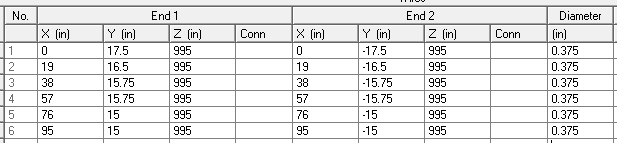

          After receiving my new MYA1506K today I reviewed my other modeled improvements and found that one used the factory supplied element holes and different element lengths and achieved about the same improved front-to-back ratio as that shown on the improved pattern above at the expense of creating four -20 dB side lobes. The element dimensions for that are shown below:
