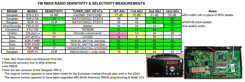

      I'd say that the Sony XDR-F1HD/S3HD are still the best FM radios to use for comparison. Forget about their HD reception if you prefer. Below are my key MEASUREMENTS on the performance of the radios that I have available for testing.
      Click image for larger version  Name:	FM Radio Selectivity Tests.png Views:	0 Size:	203.2 KB ID:	984
      The adjacent channel figures are the dB above a weak signal before reception of that weak signal is prevented. Since I do not have a RBDS generator, the sensitivity in decoding that was not tested. Due to the large number of stations not transmitting RBDS data or sending incorrect information, that seems more like a nicety rather than something as important as my other data. 65-66 dB was the limit for my test equipment and method using modulated signals.
      It appeared that the auto-bandwidth mode on the TRF6686 caused the sensitivity of a fading signal to be 2 or 3 dB better than that of a very weak signal increasing in amplitude. The better fading signal figure was logged.
