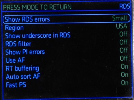

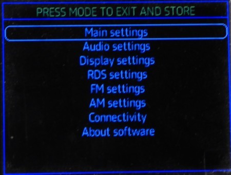

          Originally posted by crainbebo View Post
          Changing the RDS to USA? Which buttons do that?
          I am talking about a TEF6686 using version 2.00 with Patch 205 software. As I mentioned, choose "RDS Settings" instead of "FM Settings."
Name:	TEF6686 Main Menu.jpg
          The second option on that menu is "Region" which gives you the choice of USA or Europe.
Name:	TEF6686 RDS Settings.jpg
          With USA selected, the proper Pty information will be shown. Examples:
          STATION -- USA SETTING -- EUROPE SETTING
          KVNO ............ Classical ............. Other Music
          KUCV .............. Public ................. Travel
          KEZO .............. Rock ................. Education
          KTGL ........... Classic Rock ............ Drama
          The above is what I saw on my TEF6686 with the two Region settings. The information shown on my TEF6686 with the USA setting is correct.
