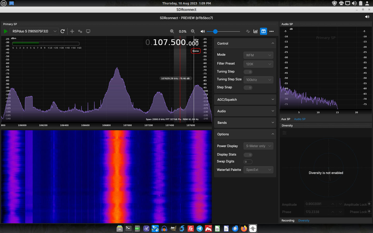

    It took them months but SDRPlay has finally uploaded the new SDRConnect software compatible with all of their RSPs except for the RSP1. It's available for Linux, Windows and Mac. I'm using it with Linux Mint 21.2 and it works fine. All it needs is RDS capability, which should be available in the not too distant future. Attached is a screenshot.
